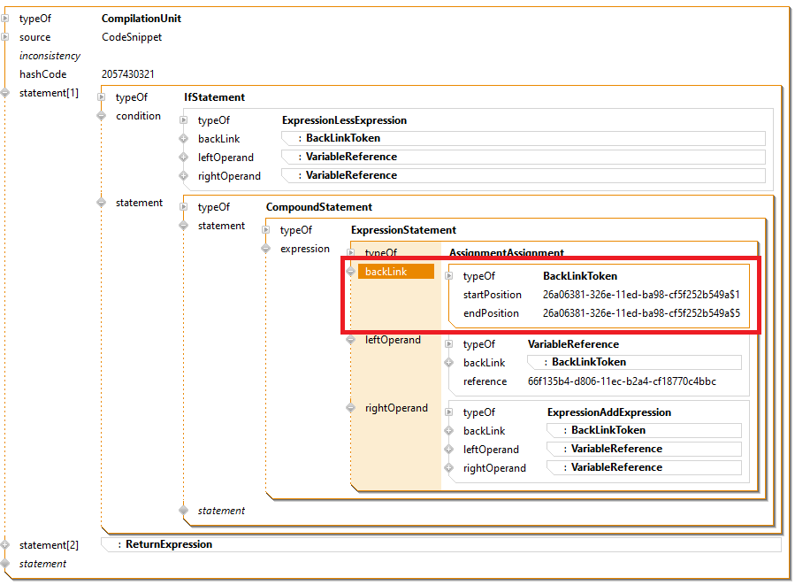

Parsed cMinus 'CompilationUnit' from codesnippet:
Each expression now has a backlink over which the range in the codesnippet is defined.
