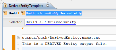

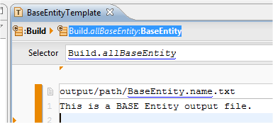

Apart from the request above, I do have an issue with templates and class hierarchies:
in my meta-model diagram I have a BaseEntity, then a DerivedEntity which inherits from the former:
They have one associated template each, BaseEntityTemplate and DerivedEntityTemplate.
BaseEntityTemplate selects by means of Build.allBaseEntity. DerivedEntityTemplate by means of Build.allDerivedEntity.
They both produce an output file with the same "rules", say: output/path/xxxEntity.name.java.
In my specific "instantiated" model, I have and instance of BaseEntity (MyBase) and an instance of DerivedEntity (MyDerived).

The first thing you should consider is, whether it makes sense to have completely different templates for BaseEntity and DerivedEntity. This makes only sense if the implementations are totally different.
Inside the template you can distinguish between BaseEntity and DerivedEntity using Filtering Contexts. If you want to generate some lines only for the DerivedEntities use a context with selector "BaseEntity:DerivedEntity" and put these lines there. Additionally, if you need to have something for BaseEntity only, you can put the break flag on the filtering context and put the lines for the BaseEntity below.
If you decide that two different templates is the way to go, you need to filter the subclasses out in the template for BaseEntity. To do this you need to create a context above (left of) the file context. (The file context is the context with the fatter line.) Then, on the topmost context you define the selector as "Build.allBaseEntity" and then use the second context as filter. To do so, you need to create a function with a name like"isBaseEntity" on the type BaseEntity which returns a boolean. Whenever the function returns false, the instance is skipped during generation. Therefore, you need to check the type in the function.
