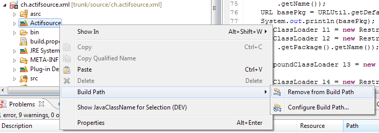

Other exceptions are ClassCastExceptions and Assertions checking for assignment compatibility. To reduce such cases, the best thing one can do is managing the classpath completely by the OSGI-Framework. As a first step to solve this issue you have to remove the classpath-container from the jdt buildpath:
Remove From BuildPath
