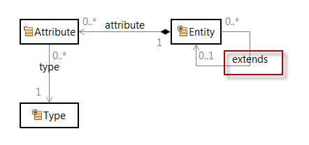

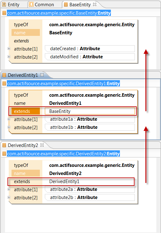

Thank you for your interesting question. I would suggest that you model an extends relationship between the entities:
Doing so allows you to model the base entities with the desired attributes:

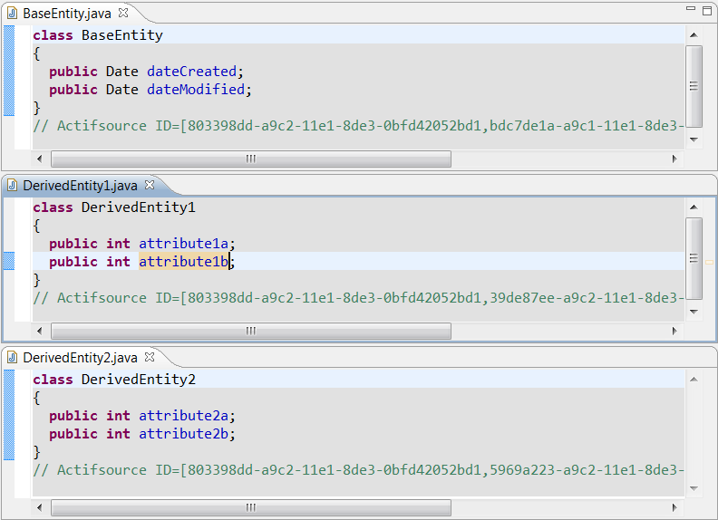

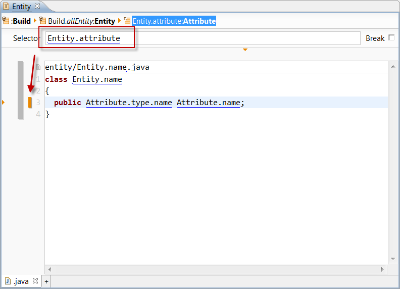

Writing standard template code you would ask for all attributes in the entity as follows:
This would lead to the following result:

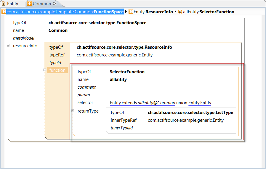

  • Create a new resource of type FunctionSpace
  • Inside, create a new ResourceInfo with typeRef Entity
  • Inside create a new SelectorFunction named allEntity
  • returnType shall be of type ListType with innerTypeRef Entity
This means that we create a function which can be called in the template on type Entity and returns a list of Entity. The idea is now to collect all base entities which can be recursively reached via the extends relation.
For that reason please enter the following selector statement:
  • Entity.extends.allEntity@Common union Entity:Entity
This means that
  • On the current entity we follow the extends relation an call ourself recursively
  • Then we create a union (set theory) with the current entity itself

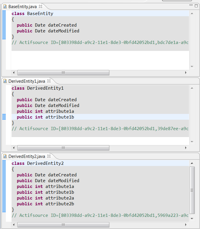

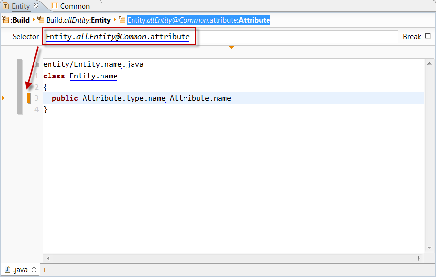

As a result, you are now able to use allEntity in your template code and ask for the attributes on this result:
As a result the generated files contains all the entity from the modeled base classes:
