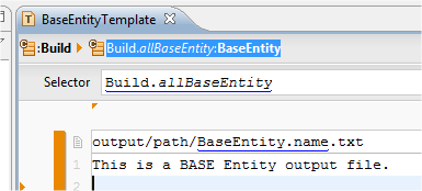

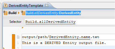

Apart from the request above, I do have an issue with templates and class hierarchies:
in my meta-model diagram I have a BaseEntity, then a DerivedEntity which inherits from the former:
They have one associated template each, BaseEntityTemplate and DerivedEntityTemplate.
BaseEntityTemplate selects by means of Build.allBaseEntity. DerivedEntityTemplate by means of Build.allDerivedEntity.
They both produce an output file with the same "rules", say: output/path/xxxEntity.name.java.
In my specific "instantiated" model, I have and instance of BaseEntity (MyBase) and an instance of DerivedEntity (MyDerived).
